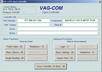

Good personal day , I have a problem to boot the KW1281 protocol , searching site articles found that during the ECU boot process should return : 00 55 01 8A, but in my it does not occur , if you use software to monitor the connection made by the VAG-COM , was presented as follows: 00 00 55 01 0A then communication occurs normally as you can see in place of 8A 'm getting 0A , however VAG -COM can make the diagnosis normally.
Dateikommentar: VAG-COM
VAG.jpg [72.44 KiB]
463-mal heruntergeladen
I am developing an application in Microsoft Visual Studio , to make the diagnosis , but I am not able to boot , this below the code I'm using :
