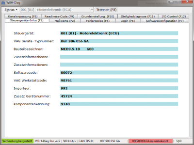

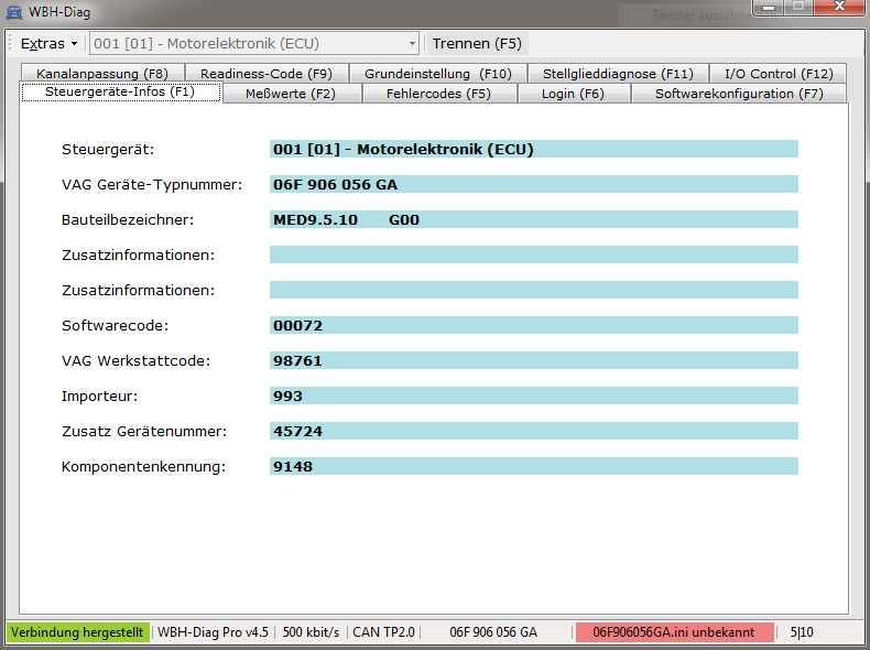

BeitragVerfasst: Freitag 29. Januar 2016, 14:42
Are you sure the ECU did not use UDS? or K-Line because the Pinout has one port for it.
My MED 9.5.1 supports TP 2.0 and it works
Can you tell me one or more VAG OEM numbers for MED 9.1 so I can probably buy one?
