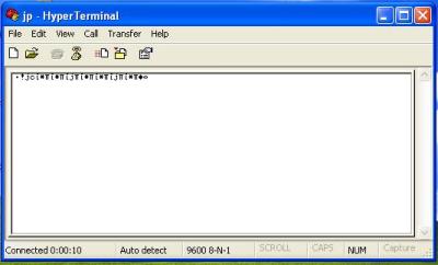

I have tried to build the remote switcher but there is problem in the rs232 communication.
by viewing the output of the RS circuit on the hyper terminal it gives garbage values.
so what woulds be the possible solution to it.

Dateikommentar: garbage value when connected to RS with baudrate 9600

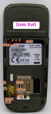

can i connect the NOKIA 1208 instead of siemens c55
IF yes then the tx of the nokia 1208 to pin 2 of ATmega8 and rx =>pin3 right ??

In most cases vice versa. RxD at Atmega is Input.
